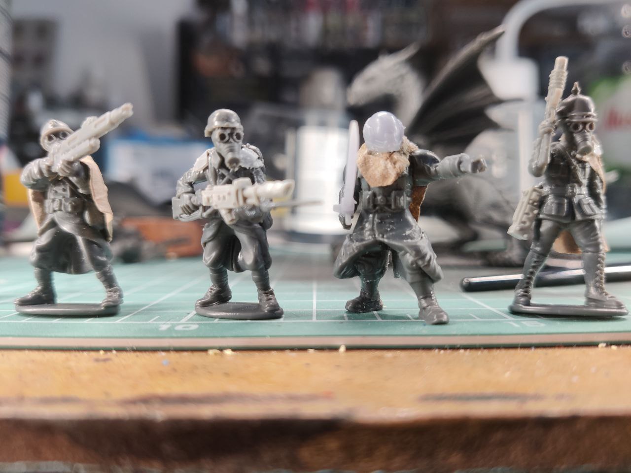

  • I have French WW1 and their bodies are significantly more up to real proportions, especially weapons. I think Eisenkern troops fit them quite well. Maybe it's because Grognards are notoriously bigger? I just tried to fit Cannon Fodder arms with weapons and it seems to kinda fit.
    Eisenkern also fit to Perry which are even slightly smaller/leaner. Maybe I've got biased by the lasgun prints and comparing them to Grognards at first, IDK. Boots are quite visible difference here, arms are noticably thicker on grognards. Can't say the same for Cannon Fodder.
  • @Drangir that is becuase the  Eisenkern are also in "historical scale" as opposed to heroic scale all the Death Field sets are in. Also in this case I am looking at making  a isekaipulp fantasy game, not a scifi game (otherwise I would likely just use the  Eisenkern or  the heroic offerings I have on hand as is).
